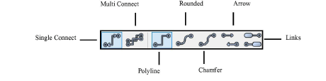

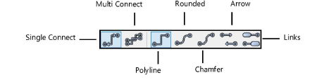

The Connect tool draws circuit connections between sockets. Circuits follow a logical flow from output to input. Once a circuit connects two device sockets, it maintains the connection between those sockets. If the devices move, the circuits refresh.
The following modes are available:
Mode
Description
Single Connect
Connects an output/IO socket to an input/IO socket
Multi Connect
Connects multiple output/IO sockets to input/IO sockets with the same signal
Polyline
Draws the circuit similar to a polyline with corner vertices; click while drawing to create vertices, routing the circuit around other drawing objects as needed
Rounded
Draws the circuit with rounded vertices (generally used to denote busses or multi circuits)
Chamfer
Draws the circuit with chamfered vertices
Arrow
Draws the circuit with arrows; on the output socket, the arrow indicates the direction of signal flow; the destination input socket displays a “reverse arrow.” This is useful when a polyline circuit would be too complex or would cross over too many lines, or to connect devices on different layers.
Links
Draws a circuit that connects devices in two different Vectorworks files
