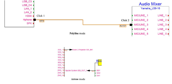

To connect sockets:
1.      Do one of the following:

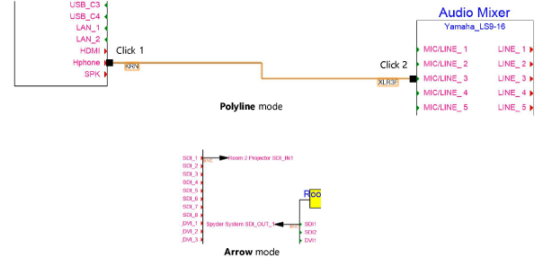

        To connect the output socket from one device to an input socket on another device, click the tool and then click Single Connect mode. Click one of the circuit vertex modes, depending on whether you want the circuit to look like a standard corner vertex polyline, a polyline with rounded or chamfered vertices, or an arrow indicating the direction of the signal flow with a reverse arrow at the destination socket.

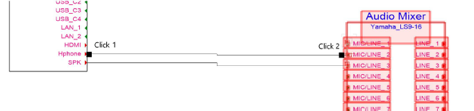

        To connect multiple sockets from one device to another at one time, click the tool and then click Multi Connect mode. Sockets with the same signal type are connected automatically between two devices.
2.      Click on the output or I/O socket.
3.      Draw the circuit or circuits, clicking if necessary to route the circuit around other drawing objects. A preview indicates the circuit’s location, and the Data bar displays the names of the sockets to be connected.
4.      Click on the input or I/O socket to create the circuit.
Vectorworks verifies that the signal direction goes from OUT to IN with the two connections. If the direction of signal flow isn’t correct, the circuit is not created.
In Multi Connect mode, click on the source device and socket type, and then click on the target device and first socket to connect. The entire target device is highlighted, and any eligible connections between the devices are created.
5.      The circuit or circuits are created.
In Single Connect mode, double-click on the next source socket to connect it to the next available socket on the same target device.
