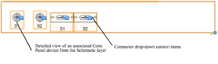

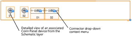

4.      In the Rack Elevation design layer, select the custom panel object. Click Get Connectors from the Object Info palette. This retrieves the connectors that are associated with the panel, and places them on the panel in a detailed, to-scale view. The correct symbol displays for the various types of connectors.
5.      Customize the connector panel display. Click the Connector drop-down context menu to change the connector type. To change the label displayed under the connector, click Set Name from the menu to open the Set Connector Name dialog box.
