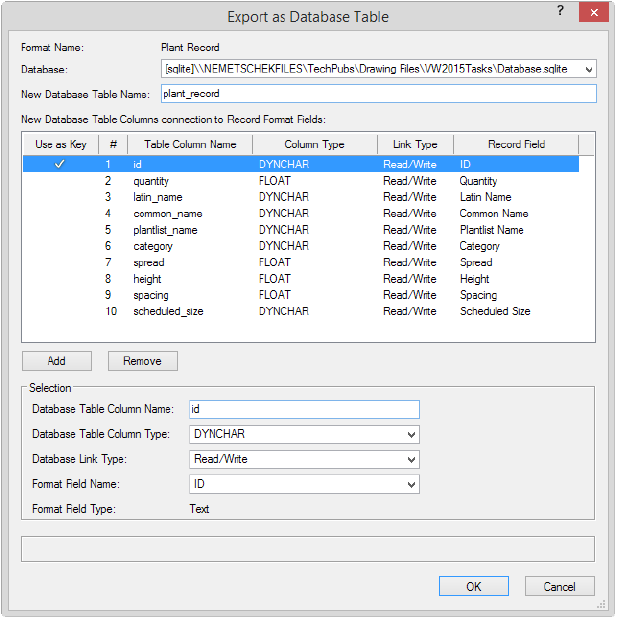

2.Select the record format, and then click Export as Database Table.
The Export as Database Table dialog box opens.
Click
to show/hide the parameters.
3.Specify the parameters of the database table columns to be created. The columns will be created in the order listed; to change the order of a database table column, click and drag within the # column.
4.Click Close to return to the Export as Database Table dialog box and make any further necessary table column adjustments.
5.Click OK.
Each record field in the format becomes a column in the new database table.

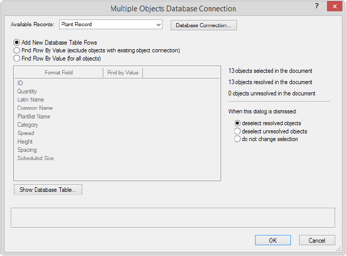

7.Select Tools > Database > Object Connection.
Since several objects were selected, the Multiple Objects Database Connection dialog box opens.
8.Select the applicable record from the Available Records list, and then select the Add New Database Table Rows option.
9.Click OK.

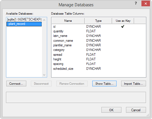

10.To verify that the database rows exist and have been populated with data, select Tools > Database > Manage Databases. The database rows have been created for the selected record format.
11.Click Show Table.
A dialog box opens, showing the database table for the associated record format.
12.The objects with the record are connected to the rows of the database table. The table is filled with data from the record formats of the objects in the drawing.
