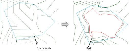

With Vectorworks Landmark, a pad modifier can automatically be created within defined grade limits. The pad is placed so that the cut and fill amounts of the underlying proposed site model are set equally, helping site designers start with a balanced solution. Batter slope angles can be different on the different sides of the modifier.

To create a pad automatically from the grade limits:
Select one or more grade limit objects.
Select the command.
The Create Pad from Grade Limits dialog box opens, and if necessary, the view temporarily changes to optimally display the area. Specify a uniform batter slope for the entire pad, or scroll with the Prev and Next buttons to set the slope individually for each side of the pad. The slope values must be greater than 0 but less than 90 degrees.

The resulting pad modifier is created and selected.
Individual slope values are retained for each grade limit object. The values can be reused for the creation of a new pad by selecting the grade limit object, and then selecting Create Pad from Grade Limits again.
