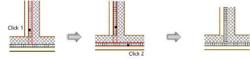

The T Join mode extends or shortens one wall component segment until it intersects with a second wall component segment. As only the first component is extended, this mode will not create corner type joins. (For those, use the L join mode.)
To join wall components with the T Join mode:
Click the tool and mode.
Select the component within the wall segment to join.
Select the second wall segment to join. The component to be joined is highlighted.
Repeat steps 2 and 3 for each component within the wall segment that needs to be joined.
