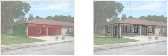

While the default settings may not relate to the size of objects in the photo, they can be used to get a good feel for how the perspective view is shaping up as control lines and settings are changed in the Camera Match object. However, if you know the size of an existing object in the photo, the Preview Object can be set to this size. In the image, the preview object was set to the dimensions from the corner to two columns wide and two columns deep. This also happens to be the extents of the proposed parts of the model. You can see just how well the view is aligning with the photo before actually clicking Set View to Match. Keep in mind that the preview object is only an aid to help with setting the parameters of the Camera Match object. While it is good to try to set up the Camera Match object so that the preview object aligns well with the photo, it is not critical to align it perfectly. Once it is close, click Set View to Match. You can always tune the view to further refine it.
When you click Set View to Match (or Fine Tune View), the preview object is turned off and the model view is set (as shown in the image to the right).
