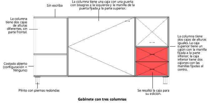

The custom cabinet preview changes to a front view and becomes interactive to specify the cabinet’s details. Click on the preview in order to activate and set the parameters on this pane; many parameters are enabled only when the preview is clicked. When you click on a column, box, or vertical divider of the preview, it becomes highlighted to indicate which section you are editing. Hold the Shift key to select multiple columns or multiple boxes within the same column; edits apply to all selected sections.
Parameter |
Description |
Section |
Columns |
Sets the number of columns in the cabinet. When you click in this field, all columns become deselected; if the number of columns is changed, columns are added to or deleted from the right side of the cabinet. |
Column Width |
If there are multiple columns, click on a column and set its width, or select Equal columns to make all columns in the cabinet the same width. As you change the width of the selected column, the widths of the other columns adjust automatically to fill the space allotted; columns that cannot fit within the overall width of the cabinet are automatically deleted. |
Boxes |
Sets the number of boxes in the selected column |
Box Height |
If there are multiple boxes, click on a box and set its height, or select Equal boxes to make all boxes in that column the same height. As you change the height of the selected box, the heights of the other boxes adjust automatically to fill the space allotted; boxes that cannot fit within the overall height of the cabinet are automatically deleted. The first click in a column selects the entire column, and the second click selects a specific box, as indicated by the highlighted section of the object. |
Side/Stile |
For selected cabinet sides and vertical partitions, sets whether it is a solid Side, a Stile, or, for end sides only, has no partition |
Front |
Door/Drawer |
Specify the door/drawer type for the selected columns or boxes, or select No Box Item to have no doors or drawers |
Handle |
For doors and drawers, specifies the handle resource from the current document or library default content |
Handle Position |
For doors and drawers with a handle, specifies the handle position. Top and Bottom settings position the handle two inches from the upper/lower edge of the door/drawer. |
Scribe |
Adds a scribe |
Height/Offset |
Set the scribe’s height and offset |
Plinth |
Adds a plinth; select whether it’s continuous or has legs |
Legs |
For a plinth with legs, select the leg type resource from the current document or library default content. Legs and casters are created without a plinth board; their height is a fixed four inches and they are placed two inches from the edges of the cabinet. |
Height/Offset |
For a continuous plinth, set the plinth’s height and offset |
Has Back |
Adds a back to the cabinet |
