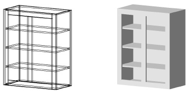

Wall cabinet parameters
Parameter |
Description |
Style |
Replace, remove, or edit the current style, or create a new plug-in object style for this object. Editing a style changes all instances in the file that use the style. |
Hide Style Parameters |
Hides the parameters that are set by style; these cannot be edited from the dialog box or Object Info palette |
Flip |
If the object is in a wall, click to flip the object orientation |
Set Position |
If the object is in a wall, click to activate the Move by Points tool in Reference Point mode and move the object by a specified distance from a reference point |
Type |
Select the cabinet type |
End Finish |
Select the cabinet finish |
Blind |
Specify the direction of the blind, or none |
Length |
Enter the cabinet length |
Uneven Length Corner |
For corner types, select whether the cabinet has an uneven length corner, and if so, enter the Left Corner Length |
Height/Depth |
Enter the cabinet height and depth |
Thickness |
Enter the thickness of the cabinet material |
AFF |
Enter the cabinet height above the finished floor |
Door mounting |
Select the cabinet door mounting type |
Number of Doors |
Select the number of cabinet doors |
Door Swing |
Specify the door swing direction |
Door Type |
Select the cabinet door type |
Panel Type |
Select the door panel type |
Mullion Type |
Select the cabinet mullion type, or none |
Number of Shelves |
Enter the number of shelves |
Arch Height Factor |
Specify the proportion of the arch height in relation to the door width (a larger value produces a taller arch) |
Handle Height |
Enter the door handle height |
Rail and Stile Width |
Select the rail and stile width |
Bevel Edge |
Select whether to bevel the outside door and drawer edges |
Bevel Inside |
Select whether to bevel the inside door and drawer edges |
Reveals |
Enter the top, bottom, side, and center reveal measurement height or width |
Glazing |
Select the glazing class or none |
Show Detail |
Select whether to draw various cabinet details. |
Cabinet/Doors |
To control appearance and visibility, select a class for each component from the list of classes present in the drawing, or create a new class. Select <Wall Cabinet Class> to place the component attributes in the same class as the cabinet object. |
Handles |
Click Handles to select a handle from a library or the current file; select a symbol from the graphical list of Symbols (or select the No Pull symbol to remove the handles) |
