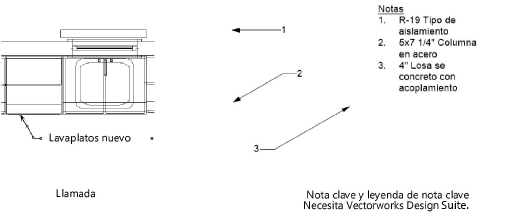

The Callout tool places callout objects to annotate items in a drawing. A callout object is a block of text attached to one or more leader lines with an optional bubble surrounding the text.
In the Vectorworks Design Suite products, the Callout tool includes extended capabilities which allow it to be used for keynotes, and to connect the callout to an external notes database to place standard notes without retyping them each time they are used. If you use keynotes, a keynote legend is automatically created.

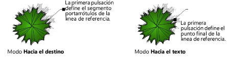

Towards Target
Click first where the callout text is to be placed, and place the final click on the object to be annotated
Towards Text
Click first on the object to be annotated, and place the final click where the callout text is to be placed

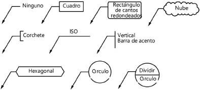

Bubble Style
Select the type of bubble to draw around the callout text or keynote number.
To place callout text both above and below the line in the Split Circle Bubble Style, press Enter between the lines of text.

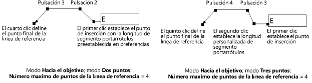

Click the applicable insertion modes, and then click to set the insertion point of the callout or keynote.
Depending on the mode, the first click defines the leader shoulder or the leader endpoint.
Continue clicking to set vertices and shape the leader line, as many times as permitted by the Max Leader Line Points value; double-click on the final point if this leader line requires fewer than the maximum number of points. The final click sets either the leader endpoint or leader shoulder, depending on the mode.
In Three Point mode, you can custom set the shoulder length by clicking in the drawing area; this requires one additional click.
