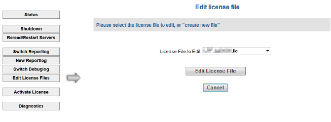

Click Edit License Files from the main Server Administration screen.
The Edit license file screen opens.
Select the license file you want to edit from the License File to Edit list.
Click Edit License File.

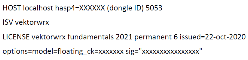

The Edit license file window opens. A portion of an example license file is described below.
5053: This is the port number of the RLM server. The default setting is 5053. This port is necessary to connect to the clients.
ISV vektorwrx: This parameter specifies the port number of the ISV server, for internal use. By default, an open port is assigned automatically.
To change the port number, type: ISV vektorwrx port=nnnn (where nnnn is the desired port number).
Do not edit any other portions of the license file. The Vectorworks Site Protection Server may become inoperable.
