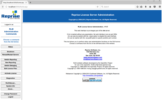

Main server administration screen
To open the main Reprise License Server Administration screen:
Select Vectorworks Site Protection > Open Web Interface from the site protection System Menu (on Windows, you can double-click on the System Menu icon).
Alternatively, launch a browser on the machine that runs the Vectorworks Site Protection Server. Enter localhost:5054 into the URL field.
The Administration screen can be viewed and operated remotely with this URL:
http://server machine's IP address:host number.
The main Server Administration screen opens.
The buttons on the left side of the Administration screen access the functions of the Vectorworks Site Protection Server. A summary of the main functions is provided here, with links to further explanation.
