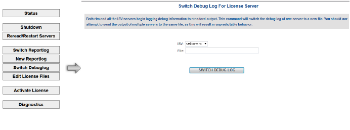

Switching to a different Debug log file
Once a Debug log has been created, you can switch from using the current Debug log and specify a different log file, without shutting down the server.
To record any data in the Debug log, you must first create the log from the command prompt/terminal.
Click Switch Debuglog from the main Server Administration screen.
The Switch Debug Log For License Server screen opens.
Select vektorwrx from the ISV list.
In File, enter the file path where the log is located, including the filename.
Click SWITCH DEBUG LOG.
The Debug log switches to the other file.
