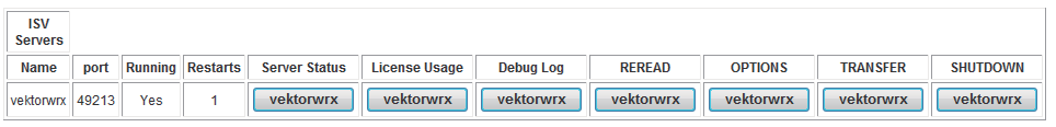

On the primary server, click Shutdown from the main Server Administration screen to temporarily shut down the ISV server.

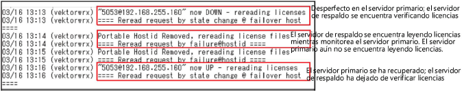

On the backup server, click Status from the main Server Administration screen to access the Status screen. From there, click vektorwrx from the Debug Log column.
Alternatively, click SHOW rlm Debug log from the Status screen.
The backup server’s Debug log displays. The status of the Debug log will indicate whether the backup server is functioning. For more information about the Debug log, see The Debug log.

On the primary server, click Reread/Restart Servers from the main Server Administration screen to start it up.

The contents of the backup server’s Debug log are explained in this example.
