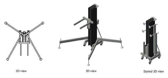

A stage lift object can be added to a drawing to represent the typical adjustable support device commonly found on stage for supporting speakers, trusses, and other stage equipment. The stage lift can be shown extended or collapsed, with a specific appearance and fork position, and can be labeled.

When selected, folds the stage lift and fully retracts the mast; forks and support legs are placed in the stored position. Certain parameters are not available when the stage lift is in stored position.
