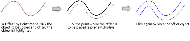

Offset by Point
Places the offset object at a distance specified by a mouse click |

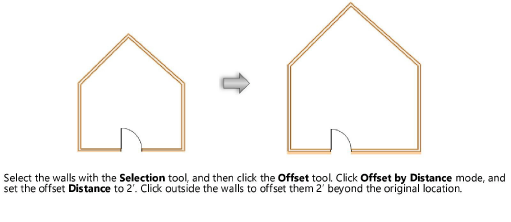

Wall Offset |
Offset from Center Line |
Offsets walls from the center line of the wall’s original location |
Offset from Nearest Edge |
Offsets walls from the nearest edge of the wall’s original location |

Offset by Distance |
Click on objects to offset |
Select the object to be offset; the object is highlighted. Click to specify the offset location relative to the selected object, and to place the offset object. To continue offsetting objects, click another object to highlight it, and then click again to indicate the offset location. |
Offset selected objects |
Click in the drawing to specify the offset location relative to the originally selected object, and to place the offset object. The offset object is now selected; to offset from that object, click again to indicate the offset location. |
Offset by Point |
Select the object to be offset; the object is highlighted. Move the mouse to adjust the offset preview if necessary, and then click to place the offset object. To continue offsetting objects, click another object to highlight it, and then click again to indicate the offset location. |
Click to set the offset point (move the mouse to adjust the offset preview if necessary), and then click again to place the offset object. The offset object is now selected; to offset from that object, click again to indicate the offset location. |

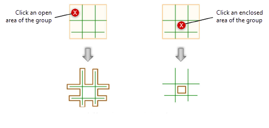

For grouped objects, the offset result depends on where you click
