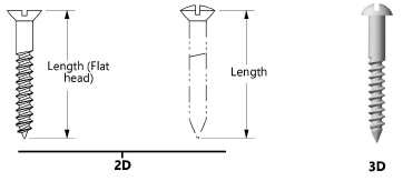

Nominal Size
Select an inch or metric nominal size
Length
For a custom length value, deselect Use Standard Length Increments and enter the length under the screw head (or overall length for flat head screws)
Slot Type
Specify the slot type
Automatically adjusts the length to the nearest increment based on size; deselect to enter a custom length
Show Threads
Draws the wood screw with threads
