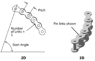

To insert a circular roller chain:
Click the tool and mode.
Parameter
Description
Standard Chain No. (Pitch)
Select the standard ANSI or ISO roller chain number; the pitch is given as a reference
No. of Teeth (Sprocket)
Enter the number of teeth on the associated sprocket
Pitch Diameter (Ref.)
Displays the pitch diameter, based on the pitch value and the number of teeth
Start Angle
Specify the angle where the chain starts
Number of Links
Enter the number of links in the chain; these will be added or subtracted from the end of the chain
Direction
Select Clockwise or Counterclockwise
Start with Pin Link
Begins the chain section with a pin link; otherwise, the section begins with a roller link
Show Pins
(3D only)
Draws the pins
Place Locus at Center
Draws the roller chain with a center locus
