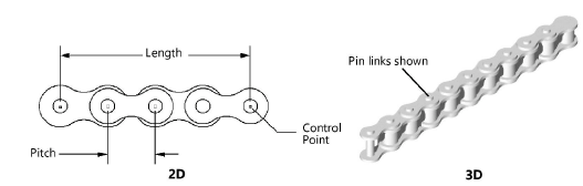

The 2D linear roller chain is a linear object, while the 3D linear roller chain is a point object.

Std. Chain No. (Pitch)
Select the standard ANSI or ISO roller chain number; the pitch is given as a reference
Length
(2D only)
Specify the length of the 2D roller chain by entering a value here or by clicking and dragging one of the chain control points; as the length increases, the number of links increases (depending on the selected pitch)
No. of Links
Enter the number of links; the length automatically adjusts
Start with Pin Link
Begins the chain section with a pin link; otherwise, the section begins with a roller link
Show Pins
(3D only)
Displays the pins
