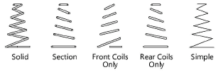

(2D only)
Select a display mode for 2D springs
