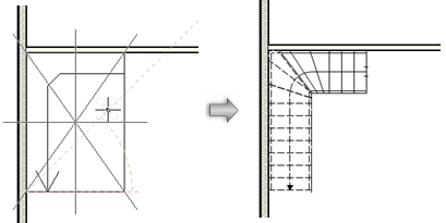

Corner to Corner mode draws stairs based on rectangles aligned with the X/Y axes. Snap to adjacent building elements to precisely place the outer boundary of the stair. If there are certain stair geometry parameters you want to set for the stairs, specify them in the Stair Settings dialog box first. The stair's overall dimension settings (Stair Width, Side, Length, and so on) adjust to match the stair's drawn outer boundary, and as many as possible of the other stair geometry settings remain unchanged in stair settings when the Stair tool calculates the stair.

Click at the stair's start point; this becomes one corner of the stair's outer boundary.
Move the cursor to the opposite corner until the desired size and placement is previewed, and click to set the other corner point.
Corner to Corner mode draws only rectangles that are aligned with the X/Y axes.
After the rectangle is placed, move the cursor inside the rectangle. As you move the cursor, the potential stair positions preview, based on the rectangle and the selected stair configuration/resource; an arrow indicates the direction of the stair.
Click to place the stair with the desired position.
The Stair tool calculates the stair based on the rectangle and the current stair settings, including the configuration and other geometry settings, such as the Tread Depth and Riser Height. If a valid stair is calculated, the stair is created. If not, either the stair fails, or you are given options to change the invalid settings.
In this example, an L-shaped stair configuration is selected
