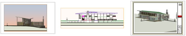

Viewports can display entire, as well as cropped, views of a drawing, with specified layer and class visibility settings, projection, render mode, and orientation parameters (complete with details, annotations, dimensions, and title block borders). Viewports can show other parts of the active document, or even portions of other documents. If the drawing changes, update the viewports to reflect the changes. Use Vectorworks-provided or custom viewport styles, accessible from the Resource Manager or Resource Selector, to quickly apply or update the same settings for all viewports in the file that use the style; see Viewport styles

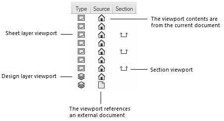

The Viewports tab of the Organization dialog box differentiates among the various types of viewports.
