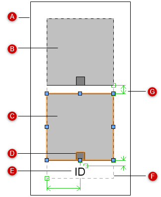

Edit the cell layout to fine-tune the image display and optionally add text fields and 2D geometry. You can create multiple images in the layout. When you add or rearrange objects in the layout, the cell frame adjusts automatically. The layout must include the frame and at least one image.
Cell layout with two images and a dynamic text field
A: Cell frame B: Placeholder for second image C: Image placeholder (selected) D: Alignment indicator E: Dynamic text field F: Bounding box of cell contents G: Constraint |
Select the legend, and from the Object Info palette, click Edit Cell Layout. For a styled legend, see Editing plug-in object styles. The cell layout displays in editing mode.
Alternatively, right-click the legend and select Edit Cell Layout.
Select the image placeholder to access image editing options in the Object Info palette, including the image width and height, vertical and horizontal alignment, and the option to include auto-dimensions when aligning objects. Click Define Legend Image to adjust the image definition (see Defining the legend image). To see how the image will look in the legend, set the Preview Display to Detail.
Use the Text tool to add static and/or dynamic text objects to the layout. From the Object Info palette, specify the appearance of the text; see Formatting text.

Editing the title layout
If the legend has the Display title option enabled, edit the title layout as desired. The layout must include the title frame and the Legend Title text field.
Select a legend, and from the Object Info palette, click Edit Title Layout. For a styled legend, see Editing plug-in object styles. The title layout displays in editing mode.
Alternatively, right-click the legend and select Edit Title Layout.
As described in Editing the cell layout, you can add text and 2D geometry objects and set constraints for them. For example, add a filled rectangle to give the title frame a contrasting color.
To adjust the margin between the title contents and the title frame, select the frame and edit the margin in the Object Info palette. The frame cannot be deleted from the layout.
When you’re done editing the layout, click Exit Graphic Legend Title Layout.
