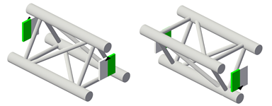

When a truss magnet is properly configured:
Its center point aligns with the center of the truss profile (also the center of the truss cross).
In mid-span connection trusses, which have multiple connection sites along the truss profile, the center point of the magnet must align with the center of the connection site; see Mid-span connection truss.
Its orientation matches the hanging angle of the truss connection.
Its connection side (with the arrow) faces outwards, towards the connecting truss.
Its arrow points to the orthogonal top of the truss profile.
Properly configured magnets in triangle trusses

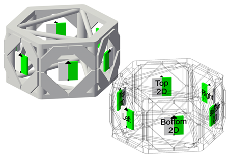

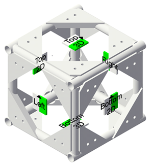

Complex configurations
In truss symbols with unusual custom geometry, the magnets may need adjustments.
The examples below indicate the type of magnets needed and where they must be placed in complex corners, hubs, and mid-span connection trusses such as grid and mod trusses.
6-way corner truss
Hub truss
