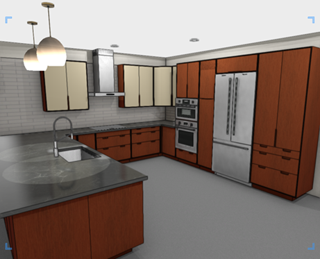

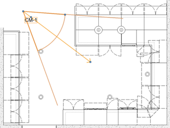

Top/Plan view showing the camera (top), and the activated camera's view (bottom)

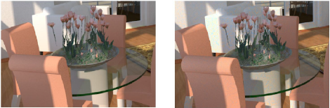

Depth of Field |
Uses the depth of field options, which control the area in which objects appear relatively sharp, while the rest are blurry. |

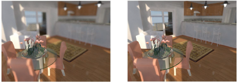

F-Stop |
Select a value, or select Custom F-Stop. F-stop determines how blurry out of focus objects are relative to the focus distance. The larger the F-stop number, the deeper the depth of field, and as a result the less blurry objects appear.
F-Stop set to .5 (left) and 1.4 (right) |

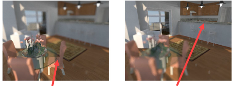

Focus Distance |
Specify the focus distance numerically or click Click to Set Focus Distance to define the focus distance based on objects in the drawing. Focus distance is the point at which objects appear sharpest in front of the camera.
Focus Distance on chair (left) and on bar (right) |

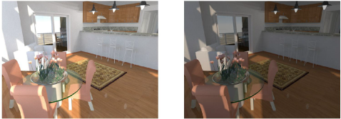

ISO Film Speed |
Select an ISO film speed. ISO is the sensitivity of the film or sensor to light. Higher values create brighter results.
ISO Film Speed set to 50 (left) and 100 (right) |

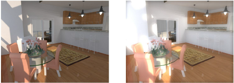

Bloom (%) |
Enter a bloom percentage; values greater than 100% are accepted. The bloom effect adds a glowing halo around the brightest areas of the image, increasing the sense that the light sources are bright.

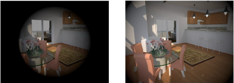

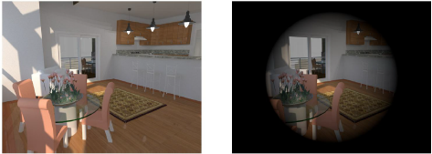

Vignetting Intensity (%) |
Enter a vignetting intensity percentage; values greater than 100% are accepted. Vignetting creates a circular darkening of the image to its edge.
Vignetting Intensity % set to 0 (left) and 100 (right) |

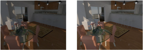

Chromatic Aberration (%) |
Enter a chromatic aberration percentage; values greater than 100% are accepted. Chromatic aberration is the effect of different light colors being refracted by the lens at different angles. It takes place mostly in blurred regions.
