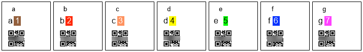

Using data from any database worksheet report or non-database worksheet in the current document, Vectorworks can automatically create ready-to-print labels on a page for Spotlight and/or ConnectCAD objects (cables, equipment, and devices). The label format defines the page layout; it reads the data from the worksheet report and draws a label for each worksheet report row.
Labels can display text, graphics, barcodes, and/or QR codes, all of which can be fixed objects or dynamic placeholders that vary for each label; each linked object gets its content from a specific worksheet column defined by the column index number. Numbers can be displayed in the standard resistor color code so that they can easily be read from a distance.

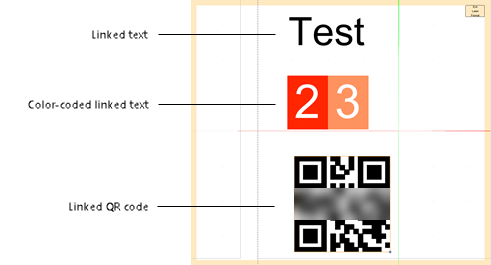

Label formats can display text, graphics, barcodes, and/or QR codes. Labels can consist of static graphics and text that appears on each label, as well as content that varies with each label, depending on the values read from the source worksheet's row or sub-row.
Adding linked text to a label format
To add linked text:
Select the label format object on a sheet layer, and then right-click and either select Edit from the object context menu, or double-click to open it in object editing mode (see Object editing mode).
Create a text field inside the label with the Text tool (see Inserting text) to serve as the placeholder for the information to display. Format the text with the desired font and style.
If a barcode font is installed on your computer, you can create a barcode label by selecting the barcode font.
In the Object Info palette for the selected text (the selection displays as Text), select the Is linked text option under ConnectCAD Text Link Data.
From the Field list, select the worksheet report column linked to the text.
For more information about linked text, see Displaying custom records. In label formats, text is linked to worksheet data instead of records or parameters.

To add color-coded linked text:
Click the tool.
Click in the label to place the color-coded linked text.
The color-coded linked text displays sample numbers. The background fill colors for the numbers are set according to the standard resistor color code.
The parameters can be edited from the Object Info palette.

You can add a QR code image to the label, linked to the values in a selected worksheet column.
To add a linked QR code:
Click the tool. In the Tool bar, select the worksheet column value to link to from the QR code.
Click in the label to place the linked QR code.
The linked QR code displays.
