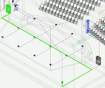

Double-click on a row in the list to highlight the entire route taken by the selected circuit. The drawing pans and zooms temporarily to show the route. Alternative routes through the cable network also display on the drawing, with different colors (change the color, if desired, by clicking on the color box in the circuit list).
Continue adding the necessary spare cables to the list and click OK.

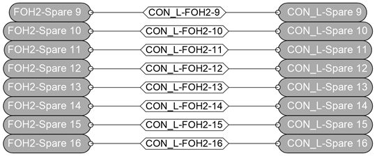

The spare cables in the Cable List are created and placed on the Spare Cabling layer. The cables are temporarily labeled according to the drop points they connect, along with an automatically incrementing number. This makes it easy to locate the spare cables connecting two drop points later.

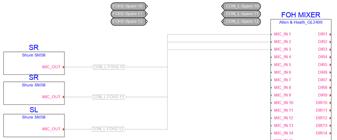

To assign spare cables:
On the final connectivity schematic, create the devices that will be connected by the spare cabling.
Select the spare cables to assign, and move them to a schematic layer by selecting a schematic layer from the Layer list on the Object Info palette.
Select the tool and mode.

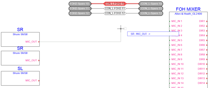

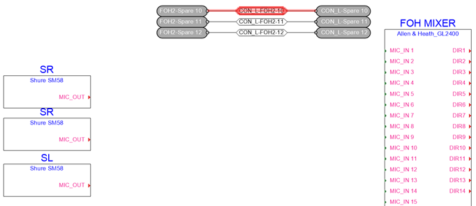

Select the spare circuit.
Do one of the following:
To draw a new circuit, click on each of the two sockets it connects.
To replace an existing circuit's path with the properties of the spare circuit, click on the existing circuit. See Transferring circuit properties.
As the circuits are reassigned, they are automatically removed from the spare designation. Delete the spare external labels.
