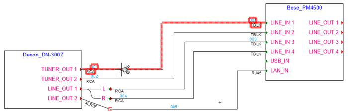

To transfer properties from a source circuit to a destination circuit:
Click the tool and the mode.
The eyedropper cursor displays.

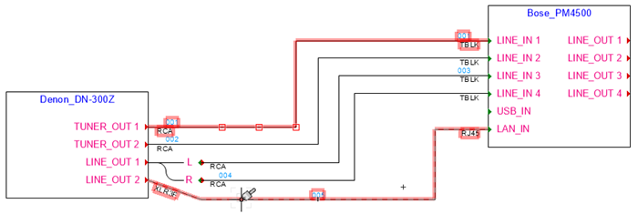

Click the source circuit with the properties that you want to transfer to a destination circuit.
The paintbrush cursor displays, and the selected circuit is highlighted.
Move the cursor over the destination circuit.
The circuit is highlighted. The path of the destination circuit will be used during the transfer.

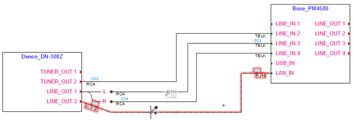

Click the destination circuit to transfer the properties. Ensure that you click the destination circuit; if you click a socket, the circuit is redrawn instead.
The destination circuit receives the properties of the source circuit, and the source circuit is removed.
