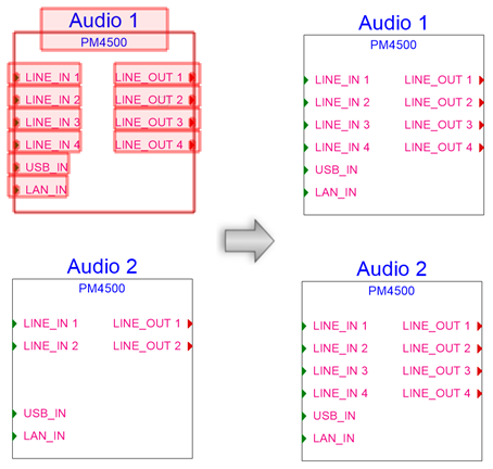

The Device tool eyedropper modes transfer device properties from one device to another. This is convenient, for example, when there are hundreds of devices with a similar make and model, and you need to add a socket to each one, or update the device properties or its graphics.
Socket parameters are copied between identically named sockets from the source device to the target device. New sockets in the source are added to the target; if there are sockets in the target that are not in the source, specify the action to take in the preferences.

The source and target socket names match
The parameters of the source device's sockets are copied to the target device sockets; the target device socket moves to the same location (relative to the device local origin) as the source device socket
A socket is present in the target device that does not exist in the source device
The target socket is deleted if that option is set in tool preferences. Connected circuits are also deleted with the socket, if that option is enabled in tool preferences.
The source device contains a socket not present in the target device
A copy of this socket is added to the target device. If another socket is present at the same location (relative to the device local origin), then the location will be moved downwards by one snap-grid until a free space is found.
