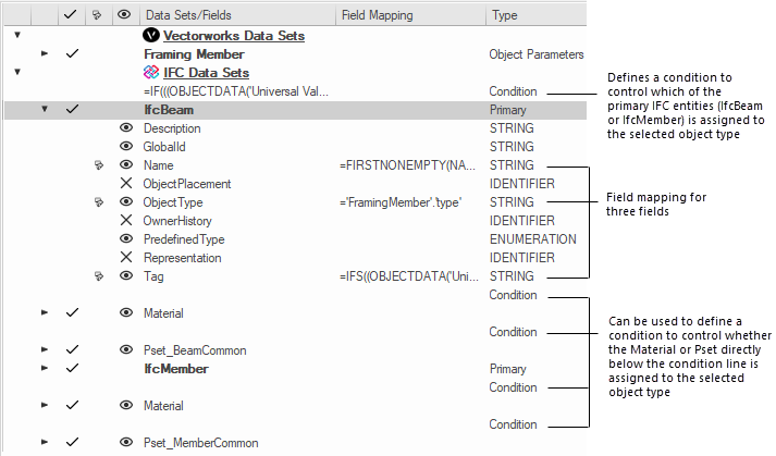

From the Data Manager dialog box, select the object from the Objects list, and then select the field or condition to map from the Data Sets list. Here's an example using the Framing Member object type:
Click Define Mapping or Define Condition.
The Define Mapping or Define Condition dialog box opens.

Build a simple formula to map one field to another, or manually enter an expert formula.
The mapping formula displays in the Data Manager dialog box. Double-click the formula to access the manual editing window, if necessary. Even for a simple formula, you might want to add a prefix and/or suffix, or add concatenation or arithmetic operations. See Entering formulas in worksheet cells for information about arithmetic operations.
