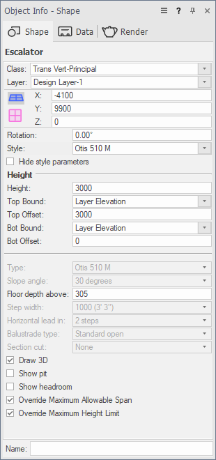

In this example, we need a better description of an escalator, including important information about the manufacturer and the step width. We also want to add some words to improve the legibility.
Formula:
=CONCAT('Escalator: ', 'Escalator'.'Type', ' Width: ', 'Escalator'.'Step width')
Result:
Escalator: Otis 510 M Width: 1000 (3' 3")

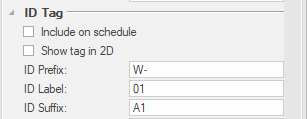

In another example, we need to set up the name of the window object to come from the Vectorworks name. If there is no Vectorworks name, we want to combine the ID Prefix, ID Label, and ID Suffix fields. If all of those parameters are empty, we want to use the word "Window" to identify the window.
Formula:
=FIRSTNONEMPTY(OBJECTDATA('General Name'), CONCAT('Window'.'IDPrefix', 'Window'.'IDLabel', 'Window'.'IDSuffix'), 'Window')
Result with no Vectorworks name:
W-01A1

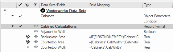

To automatically attach custom records and data to Vectorworks plug-in objects as they're added to a drawing, create a record format with the data fields you want, and then map fields to an appropriate constant value, parameter, or style for that object. This makes it easier to use the various Vectorworks features that report object data, such as worksheets, data tags, and data visualizations.

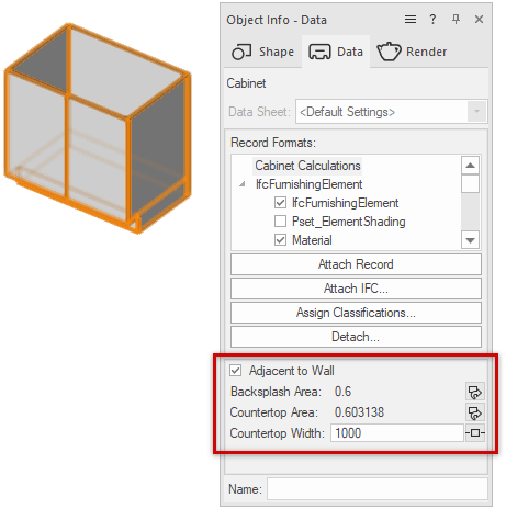

In this example, the "Cabinet Calculations" record format has been created and added as a data set for the Cabinet plug-in object.
Countertop Width: Mapped to the cabinet's Width parameter (the linear measure of the countertop)
Countertop Area: We add a 50 millimeter overhang to the countertop and calculate the area, then divide by 1000 * 1000 to convert the result from square millimeters to square meters (width/depth units are millimeters)
Formula: =('Cabinets'.'CabWidth' * ('Cabinets'.'CabDepth' + 50)) / 1000000
Adjacent to Wall: Not mapped; in the Data tab of the Object Info palette, the user defines whether the cabinet is adjacent to a wall, and therefore requires a backsplash
Backsplash Area: If a backsplash is needed, the area is 0.6 meters (the backsplash panel height) * width of the countertop / 1000 (to convert from meters to millimeters). Note that this formula refers to two other fields in the same record.
Formula: =IF(FIRSTNONEMPTY('Cabinet Calculations'.'Adjacent to Wall', FORMATFIELD('Cabinet Calculations', 'Adjacent to Wall')), (0.6*FIRSTNONEMPTY('Cabinet Calculations'.'Countertop Width', FORMATFIELD('Cabinet Calculations', 'Countertop Width'))/1000), 0)
If you delete the record format from the mapping, the record will be detached from all cabinet instances in the drawing.
When a cabinet is placed in the drawing, the Data tab of the Object Info palette shows that the record data has been attached automatically. For each mapped field, the setting in the Data Manager's Editing (
) column controls how the field can be edited. Adjacent to Wall is an unmapped field. The mapped values for Backsplash Area and Countertop Area aren't editable by default; click the button to edit. The mapped value for Countertop Width is editable by default.

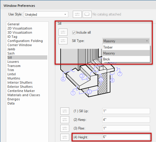

In this example, we want to calculate the IfcWindow.OverallHeight based on the settings of our window object.
The Height parameter contains the correct value, as long as the window has no sill or, if it has a sill, it is a Brick Sill type. In any other situation, the sill Height value needs to be added to the window Height.
Formula:
='Window'.'OverallHeight' + IF('Window'.'IncludeSill' & ('Window'.'SillStyle' <> 'Brick'), 'Window'.'SillHeight', 0)
Result, when there is no sill, or if the sill type is Brick (adding 0 to the Height value):
2000.0
Result, when there is a sill, and it is not Brick (adding 150.0 to the Height value):
2150.0

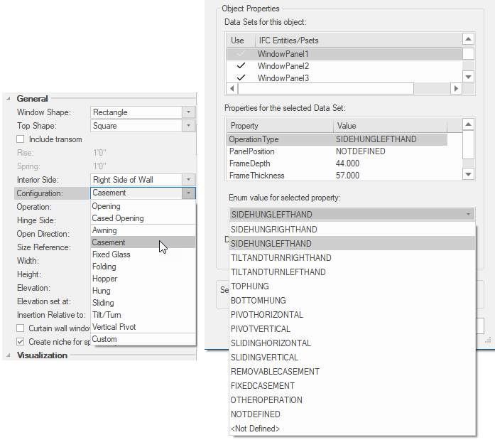

IFC data requires many "enumeration" kinds of data fields, such as PredefinedType, OperationType, ShapeType, and so on. Sometimes, there is no one-to-one correspondence—the current settings differ from IFC, no valid data sources can be mapped directly, or the values are written in another language.
In this example, we will map the Configuration list from the window to the required OperationType of the IFC Window Panel data set, using one of the selector functions.
Formula:
=FIRSTNONEMPTY(IFS('Window'.'Configuration' = 'Opening', 'FIXEDCASEMENT',
'Window'.'Configuration' = 'Cased Opening', 'FIXEDCASEMENT',
'Window'.'Configuration' = 'Awning', 'TOPHUNG',
'Window'.'Configuration' = 'Casement', 'SIDEHUNGLEFTHAND',
'Window'.'Configuration' = 'Bi-parting Casement', 'SIDEHUNGLEFTHAND',
'Window'.'Configuration' = 'Fixed Glass', 'FIXEDCASEMENT',
'Window'.'Configuration' = 'Fixed Glass - No Sash', 'FIXEDCASEMENT',
'Window'.'Configuration' = 'Folding', 'NOTDEFINED',
'Window'.'Configuration' = 'Hopper', 'BOTTOMHUNG',
'Window'.'Configuration' = 'Single Hung', 'SLIDINGVERTICAL',
'Window'.'Configuration' = 'Double Hung', 'SLIDINGVERTICAL',
'Window'.'Configuration' = 'Horizontal Slider', 'SLIDINGHORIZONTAL',
'Window'.'Configuration' = 'Tilt/Turn', 'TILTANDTURNLEFTHAND',
'Window'.'Configuration' = 'Vertical Pivot', 'PIVOTVERTICAL'

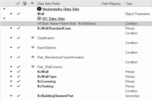

Condition to map wall styles to different entities
For example, you might have a file with four wall styles: ExternWall, InteriorWall, Footing, and VirtualWall. In the data mapping for the wall plug-in object, we add two new Primary entities: IfcCovering and IfcFooting. Using the Condition field we set a rule to map the appropriate IFC entity by wall style.
Formula:
=IF(Style.'Name'='ExternWall', 'IfcWallStandardCase', IF(Style.'Name'='InteriorWall', 'IfcCovering', IF(Style.'Name'='Footing', 'IfcFooting', 'No-Export')))
Result:
The exported file will contain walls with one of three IFC entities, depending on the wall style. Walls with the VirtualWall wall style are not mapped to anything, and will not be exported.
A: "InteriorWall" style maps to IfcCovering B: "VirtualWall" style is not mapped (and not exported) C: "ExternWall" style maps to IfcWallStandardCase D: "Footing" style maps to IfcFooting |

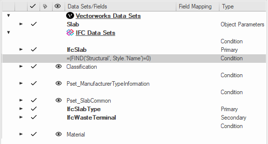

Pset condition for a slab object
Formula:
=(FIND('Structural', Style.'Name')=0)
Result:
If the slab object's Style name starts with "Structural," the Classification Pset will be attached to the slab.

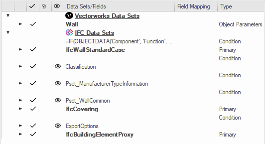

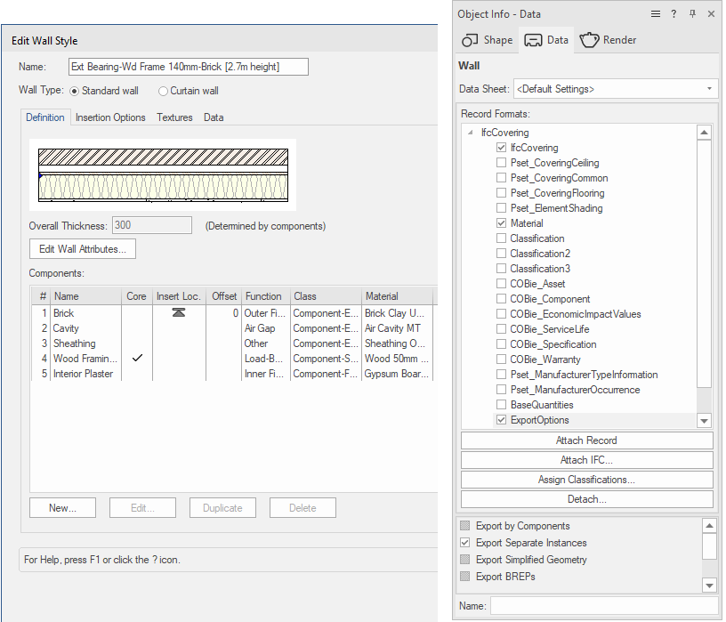

Condition to export an object as multiple entities
Conditions can be used when exporting a single object as separate entities. Here we have a wall with multiple components. Using the Function field from the wall style, a different IFC entity can be mapped to each component during export.
Formula:
=IF(OBJECTDATA('Component', 'Function', T=INDEX)='Load-Bearing', 'IfcWallStandardCase', IF(OBJECTDATA('Component', 'Function', T=INDEX)='Inner Finish', 'IfcCovering', IF(OBJECTDATA('Component', 'Function', T=INDEX)='Outer Finish', 'IfcCovering', IF(OBJECTDATA('Component', 'Function', T=INDEX)='OTHER', 'IfcBuildingElementProxy', 'NoExport'))))
Result:
In the IFC file the wall is represented with three different entities: two IfcCoverings, IfcWallStandardCase, and IfcBuildingElementProxy. The component marked with "Air Gap" as its function is not exported.
Because it is possible to have walls with no core component, and the Data tab on the Object Info palette only allows for one entity to be visualized, the entity visualized is always the one mapped to the first component. This does not affect the export in this case.

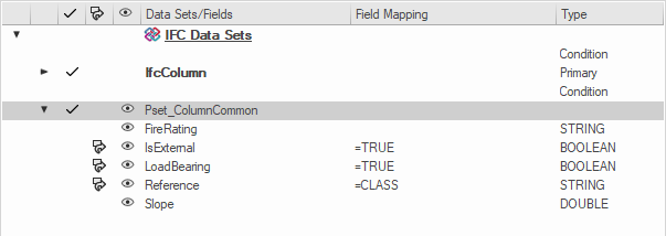

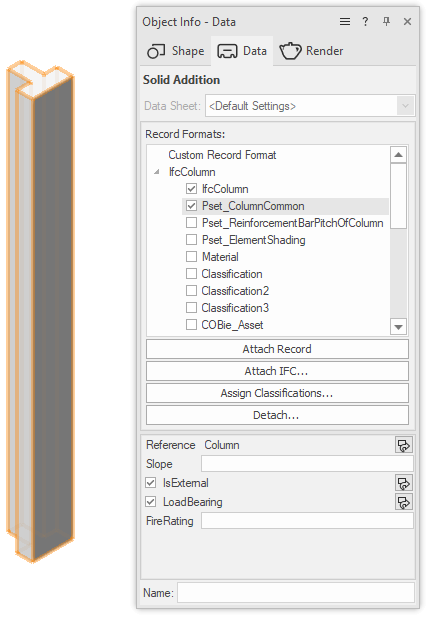

Symbols and custom geometry must have IFC data attached or mapped to be exported. Their IFC data mapping is based on the settings of their designated IFC entity type.
In the Data Manager dialog box, we add Pset_ColumnCommon and map the Reference field to the class name of the object. We can also add fixed values TRUE for IsExternal and LoadBearing.
We can see the default mapping in the Data tab of the Object Info palette.

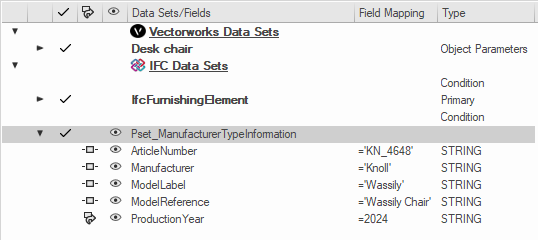

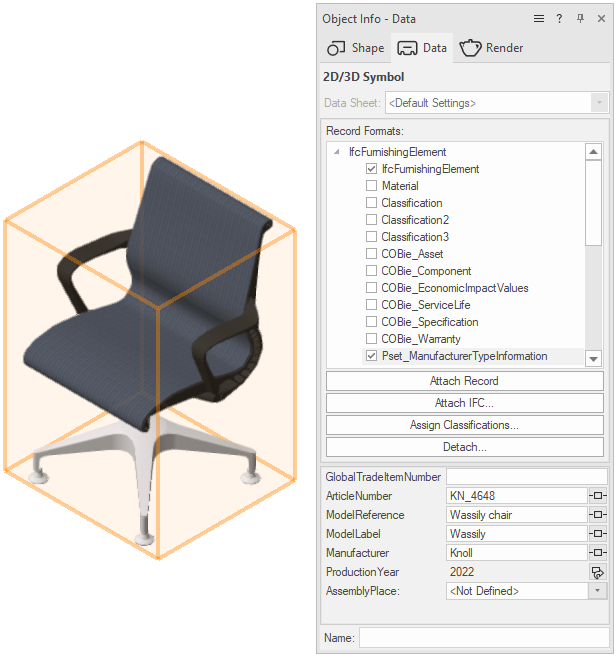

For symbols, you can create mappings based on either the symbol's IFC designation or the name of the symbol definition. In Data Manager, we select the symbol definition and then click Add Data Set to define the required IFC data sets that we want to be exported. For example, we add Pset_ManufacturerTypeInformation and then map all the fields to fixed values, since they are the same for all instances of this symbol.
Now, without even attaching IFC data to the symbol definition or to any symbol instances, the symbol is exported as an IfcFurnishingElement with Pset_ManufacturerTypeInformation. We can see the default mapping in the Data tab of the Object Info palette.

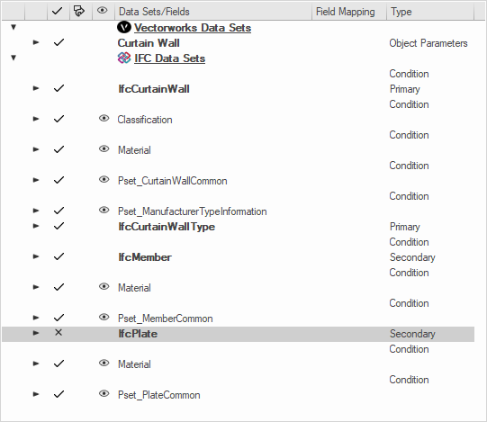

Primary and secondary entities
For aggregate objects, primary and secondary entities give you more precision with the IFC data layout. In this example, the curtain wall has IfcCurtainWall as a primary entity set. The secondary entities are IfcMember (frames) and IfcPlate (panels). By turning off, replacing, or completely deleting a secondary entity, you can control the export of the frames and panels.
