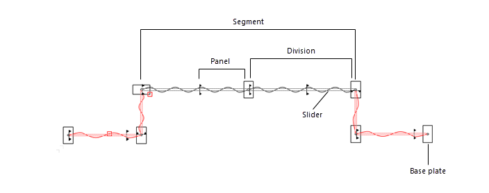

The Soft Goods tool creates pipe-and-drape assemblies typically used in event planning, such as when creating temporary booths in a convention center. To draw a pipe-and-drape assembly, either use the Soft Goods tool, or create a closed 2D shape and then select the Create Objects from Shapes command (see Creating objects from shapes).

Slider Options |
The number of sliders (divisions) created depends on the length of the entire assembly, the selected Slider Options range, and the Target Length specified. Select from a list of standard slider size ranges, or select Custom to create a non-standard slider size, and enter the Divisions per Segment to include. |
Target Length |
For standard Slider Options ranges, enter the ideal slider length. If the value entered falls within the selected Slider Options range, the tool calculates the best length based on even divisions of the total Pipe-and-Drape run length. If the value entered falls outside the selected range, the tool adjusts the value to fit within the range. |
Divisions Per Segment |
For Custom Slider Options, enter the number of divisions per segment |
Actual Length |
Displays the actual calculated slider length used; for a multiple-segment object with different slider lengths, the parameter indicates widths vary |

Running Length |
For multiple segment assemblies, displays the total length of the pipe-and-drape assembly |
