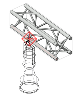

When a load object is created, it can be easily attached to a rigging object when Auto-position loads when created is selected on the Spotlight preferences: Loads and Rigging pane. The load is attached when it is placed directly on a rigging object, or placed within the specified Pick Radius of a rigging object. Valid rigging objects (or the chords of truss objects) are highlighted as the cursor moves over them, when Snap to Object is on.
When inserting loads onto truss objects created with the Truss tool, cables and bridles snap to the middle of the truss object. Objects like lighting devices, speakers, video screen objects, etc. snap to the chords. If there are several chords on top of each other, while inserting in top/plan, the inserted object will be at the bottom one. Press the Alt key (Windows) or Cmd key (Mac) while inserting the object to snap to the top-most chord facing upwards. However, if objects are being dragged or duplicated they will snap to the nearest chord.
During insertion, the light snaps to the bottom chord
