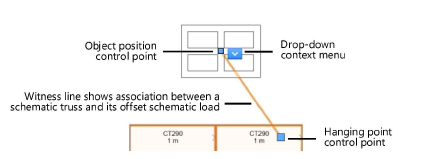

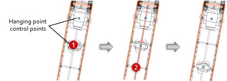

Schematic objects display different control points, depending on the position of the schematic load relative to the schematic rigging object. All schematic loads display a hanging point control point, corresponding to the schematic load’s actual location on the schematic rigging object. When a schematic load is offset from its associated rigging object for display purposes, an object position control point displays on the offset load. A witness line connects the two control points.

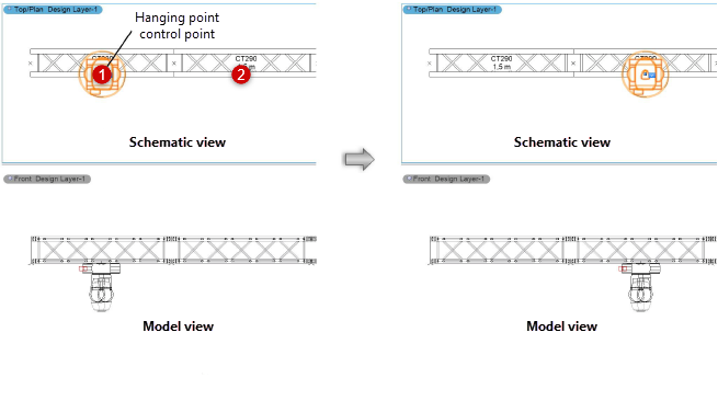

Hanging point control point: To adjust the load's actual position, click the hanging point control point and click again in the desired location; snapping allows you to precisely set the hanging point on the schematic rigging object. The load moves in the model to match the new hanging point. If the schematic load is offset, its offset position does not change, but the witness line adjusts to stay connected with the hanging point.
From the schematic view, move the hanging point control point to move both the schematic load and the model load

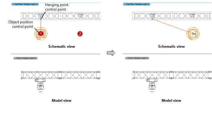

Object position control point: If the schematic load is offset from its schematic rigging object, the hanging point control point displays on the schematic rigging object, and the object position control point displays on the offset load. Adjust the schematic load's offset position by clicking the object position control point and clicking again in the desired location. The hanging point control point does not move, but the witness line adjusts to maintain the connection. Since the load's actual position has not changed, the model does not update.
If the object position control point is moved back to the associated schematic rigging object, the witness line is removed, and the load's position is updated in both the schematic view and model.
From the schematic view, move the object position control point to move the offset load. The model does not update, unless the object position control point is moved to a new hanging point on a schematic rigging object.
