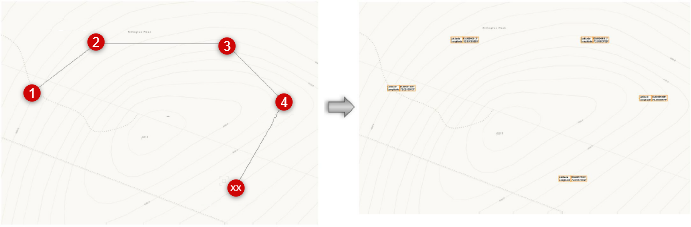

In Vertex mode, click to set vertices, placing a stake at each vertex. Double-click to stop placing stakes.
In Vertex mode, each click places a stake. In this example of five stakes placed, a topographic map was selected for the service.
