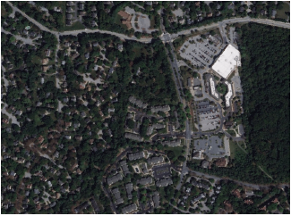

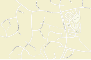

Select a map or a satellite view for the background image. The Geolocate tool toggles between these two types of view modes; one is always selected.

Map
Displays a map image
Satellite
Displays a satellite image
