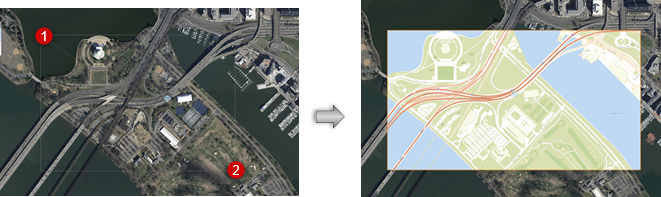

The Geoimage tool places a portion of a map or other raster-based georeferenced image into the drawing. The image becomes a drawing object that persists after the tool is deselected, for reference or for incorporation into the final drawing.
Due to licensing restrictions, the image displays while working in the file, but it cannot be saved with the file for offline use unless you are logged in with an ESRI account. Update the geoimage from the Object Info palette to download the image again, after saving the file.
The tool’s modes allow you to draw an area to create an image based on a service that may be different from the background image’s service. For example, you might need to include a soil map or hydrological map as a geoimage in the drawing. To navigate to the right location and determine where to draw the bounds of the geoimage, you can use a different service for the background imagery, one that provides context such as streets, labels, or lot lines.

To draw an area and create a geoimage object:
Before using the Geoimage tool, first geolocate the drawing to obtain the desired location, by doing one of the following:
Set specific location values in the Document Georeferencing dialog box; see Specifying document georeferencing
Use the Geolocate tool for Geolocating the drawing and obtaining the desired location.
Click the tool.
The Geoimage tool captures an image according to the mode. Click Geoimage Preferences to open the Geoimage Preferences dialog box and set the image resolution options. The parameters can be edited later from the Object Info palette.
Parameter
Description
Service info
Displays the server and type of service selected for the geoimage
Select Service
Select the service from the Provider list on the Tool bar; edit the service from the Object Info palette of an existing geoimage object
Image options
Determines the resolution of the geoimage; select Automatic to download an image based on the drawing area’s size and zoom level, which determines how many pixels to display on the screen. The image is based on the number of horizontal pixels. (Very high-resolution displays do not increase the number of pixels requested, as this could overload the servers with too many pixels requested and prevent the download.)
Select Custom to enter the number of horizontal pixels for the image source (the vertical pixels are automatically calculated based on aspect ratio).
A high Custom resolution could result in performance issues, since the background image takes up the entire background of the drawing. The map quality may be poor or it may not be able to be downloaded, particularly for high-resolution requests over a small area.
Select a display mode for the background image, which may be different from the geoimage's display.
Select either Rectangle or Vertex mode, depending on the geoimage shape required.
Select the Provider service.
The geoimage is created.
