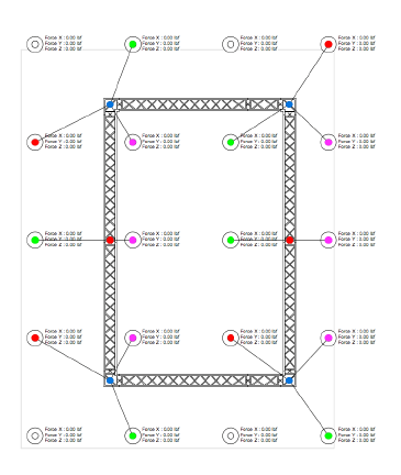

When a truss lacks adequate rigging points directly overhead, a bridle can be used to support the truss. Add bridles to a venue file that already contains the event rigging.

Use the Bridle tool to insert bridles in the drawing.
If the roof cannot sustain horizontal forces, a mother grid may be needed to support the bridles.
From the Bridle Configuration dialog box, adjust how one or more bridles are built from the available parts.
Calculate the forces applied to the rigging system (Braceworks required). Make changes to the system as needed.
