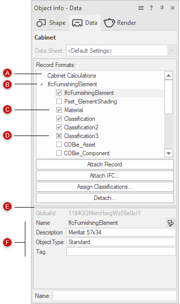

A: Record format attached to the object
B: IFC property sets attached to the object
C: Check mark indicates the property set will be exported
D: X indicates that IFC data mapping has suppressed export of the set
E: Adjusts the size of the Data tab sections
F: Displays and allows editing of the fields in the selected set
