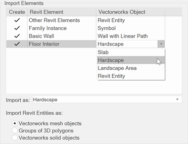

Import Elements
Elements list
The list displays the Revit elements present in the imported file. Click to place a check mark in the Create column next to elements to include in the import; at least one element must be selected.
For each element selected for import, click the Vectorworks Object column, and then click the disclosure arrow to the right of the current object type to change the Vectorworks object type for that element.
Only Vectorworks object types that are appropriate matches for the Revit element being imported are available for selection.
A Vectorworks object type change made in the elements list or in the Import as field automatically updates the other location.
Import as
Select one or more rows in the elements list, and select the Vectorworks object type for those rows.
If different Revit elements are selected, all potential Vectorworks object types are available in the Import as list, but only appropriate Vectorworks object types can be assigned to a Revit element. For example, if the selection includes Basic Wall, Floor Interior, and Floor Exterior elements, and Slab is selected from the Import as list, only the two floor elements are assigned the slab Vectorworks object type. The wall cannot be imported as a slab.
