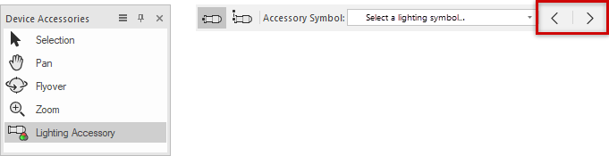

In accessory edit mode, the view and visibility settings change temporarily to assist with editing. The available tools display in a special Device Accessories palette. This includes the Lighting Accessory tool, which behaves differently from the same tool in the drawing area.
In accessory edit mode, the tool has different modes and provides arrow buttons for scrolling through a selection of lighting devices. Use the arrows to locate the device you want to edit. The drawing origin and the working plane center match the insertion point of the displayed lighting device.

Use the Lighting Accessory tool to insert accessories in default or custom positions. If multiple lighting devices were selected, click the arrow buttons on the Lighting Accessory Tool bar to navigate to the desired device. See Inserting accessories in accessory edit mode.

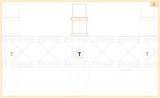

Only the 2D component of each accessory is visible in Top/Plan view. Only the 3D component is visible in 3D views.
Adjust the accessory location and rotation for 2D and 3D views.
If you're working with different types of lighting devices, use the arrow buttons on the Lighting Accessory Tool bar to scroll through the devices. Make sure the accessory edits you make for one device look right for the same accessory on other devices.
