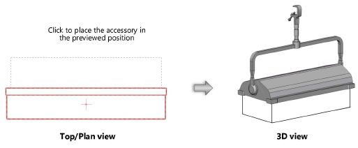

To insert an accessory on a lighting device:
Click the tool and mode.
Click Accessory Symbol to select an accessory from the Resource Selector.
Click a lighting device to insert the accessory in the default position. Lighting devices are highlighted as the cursor moves over them. On a multi-cell lighting device, a diamond highlight indicates the cell where the accessory will be inserted. A preview shows where the accessory will be placed.

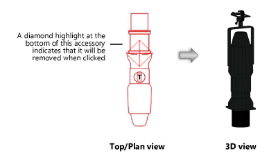

To remove an accessory:
Hover the cursor over a lighting device with accessories; a diamond highlight indicates which accessory will be removed.
Click to remove the desired accessory.
