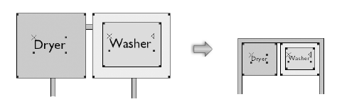

Unless you are scaling the entire drawing, the Scale Objects command does not scale symbols directly, although it can scale symbols in object editing mode. Use the Object Info palette to scale a symbol instance directly in the drawing, as described in Scaling symbols from the Object Info palette.

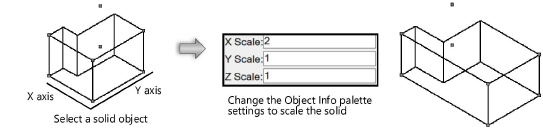

Scaling solids asymmetrically
Solids can be scaled asymmetrically, through both the Scale Objects command (see Scaling objects) and the Object Info palette. The internal components of the solid do not change, and the solid can still be edited after the scaling operation. Spheres, hemispheres, and cones cannot be scaled asymmetrically.
In the Object Info palette, enter a scale factor in the X Scale, Y Scale, or Z Scale field to scale the selected solid along the specified axis.
A selected solid can also be scaled asymmetrically by selecting the Modify > Scale Objects command and entering an Asymmetric scale factor. However, the current view must be aligned with the solid’s matrix for scaling to occur.
Symbol instances placed in the drawing can be scaled from the Object Info palette; this is an advantage because different sizes of the same symbol do not require a new symbol for each size.
A 2D symbol can also be scaled interactively using the Single Object Interactive Scaling mode of the Selection tool. See The Selection tool.

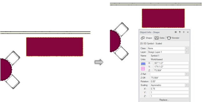

To scale a symbol instance:
Select the symbol instance in the drawing area.
From the Object Info palette, select Symmetric or Asymmetric Scaling.
For Symmetric scaling, enter the scale Factor. For Asymmetric scaling, enter the scaling factor along the specified axis.
Page-based symbols can only be scaled symmetrically.
The symbol is resized. The Object Info palette displays Scaled at the top of the Shape tab for symbols that have been scaled. Other instances of the same symbol in the drawing remain unscaled.
The table was too long and close to the chair, so it was scaled along the X axis
