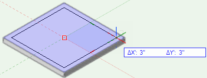

From the Tool bar, click the Push/Pull Combine mode  of the Rectangle tool.
Click in the center of the box extrude surface and drag toward a corner; click to create a 5" square.
Hover over the square to access Push/Pull mode. Drag downward past the bottom of the extrude (-6 1/2") and click to complete the push operation.

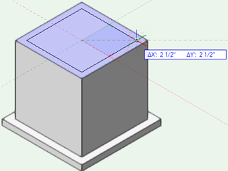

Click the Selection tool . While pressing the Ctrl key, click the bottom left corner of the box bottom and drag it straight upward to create a duplicate extrude 6 1/2" above the box bottom.
Click the Oval tool , and then click the Center mode  from the Tool bar.
Hover the cursor over the box top to activate the automatic working plane. Click in the center of the extrude surface and move the cursor toward one edge. Click to set the minor radius of the oval at 1". Then move the cursor toward an adjacent edge; click to set the major radius at 2" and create the oval.

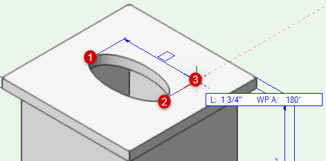

Click the Unconstrained Linear Dimension tool , which lets you create dimensions at any angle.
From the Tool bar, select one of the preset dimension standards (Standard) and the document units (Units).
You can make a custom dimension standard and custom dimension units to meet specific requirements.

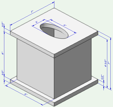

Use each of the tool modes to dimension different parts of the box. Click two points to dimension, and drag away from the object to preview both the length of the witness lines and the plane the dimension will be placed on. Click to set the dimension location.
If the mode can show multiple dimensions, click all the points you want to include, and double-click the last point to complete the dimension.
There are three modes available:
Unconstrained Linear : Dimension with a single measurement
Unconstrained Chain : Continuous chain of dimensions
Unconstrained Baseline : Set of dimensions measured from the same baseline point
Add a set of unconstrained baseline dimensions

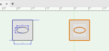

The new sheet layer displays, with the viewport selected. Right-click the viewport, and select Edit Annotations. The drawing area has an orange border to indicate you're in editing mode.

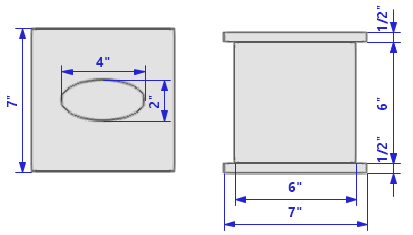

Since the viewport is in Top view, click the Constrained Linear Dimension tool , which constrains the dimension lines to the X or Y axis of the plane where the dimension is created. Add some horizontal and vertical dimensions to the box. Click Exit Viewport Annotation to exit editing mode.
You can place multiple viewports on the same sheet layer to show different views of the same objects.
Two viewports showing the box dimensions in Top view (left) and Front view (right)
