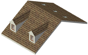

Once a roof object or a roof face has been created, use window symbols to add dormers and skylights.
Creating dormers
You can create a wide variety of dormers in roof objects and roof faces. A dormer can be set to the same style as the roof, to create a uniform appearance.
Dormer walls are always drawn in a clockwise direction for easy texture application.

The dormer with window is created and placed according to the parameters specified. A hole is automatically created in the roof where the dormer walls exist.

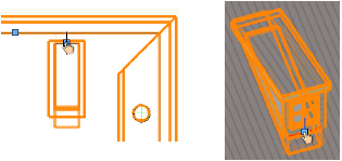

To edit a dormer:
Select the roof or roof face.
Selection handles display around the roof or roof face and at the location of each dormer and window.
Position the cursor over the selection handle for the dormer and click.
The Edit Roof Element dialog box opens, with the dormer parameters displayed.
Edit the parameters as described in Creating dormers.
To remove the dormer completely, select Remove object.

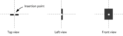

When creating your own skylight symbols, set the insertion point of the symbol at the back and center of the symbol.
The insertion point of the symbol determines whether a skylight will be flush or surface-mounted.

To edit a skylight:
Selection handles display around the roof or roof face and at the location of each dormer and skylight.
Position the cursor over the selection handle for the skylight and click.
The Edit Roof Element dialog box opens, with the skylight parameters displayed.
Edit the parameters as described in Creating skylights.
To remove the skylight completely, select Remove object.
