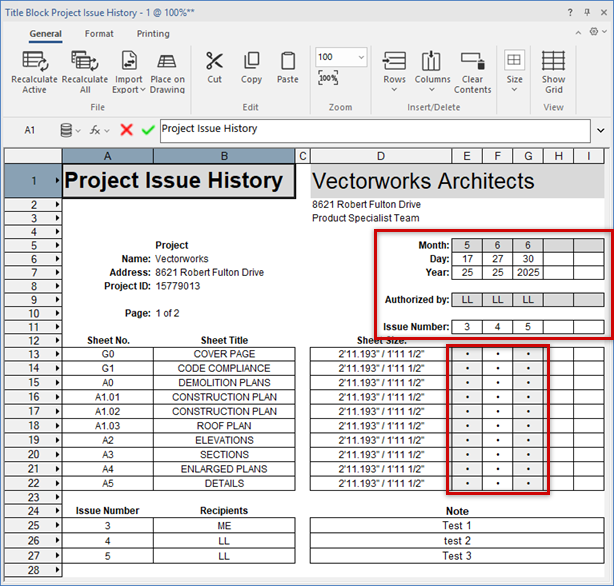

Design SuiteProject revision and issue history worksheets
The Title Block Manager creates worksheets with the information from the data records and record formats maintained by the title blocks marked for inclusion in the Title Block Manager operation.
Revision and issue data can also be extracted from title block borders using the Create Report command; see Creating reports.
The worksheet appearance (such as font, color, and so on), field label text, and design company information including a logo can be customized (see Concept: Worksheet overview) and saved into the user folder to be used for future reports. However, rows should not be added or deleted in the top section of the worksheet that displays the issue dates and approvals, since the worksheet formulas depend on these rows. For the issue history report, dots indicate which sheets are in each issue. For the revision history report, the number of the last revision for each issue displays; for sheets that were issued with no revision, a dot displays.
When the issue history and revision history reports are run, the Title Block Manager checks to see if the report already exists in the file; if so, it writes new data into the existing worksheet. If the report doesn't already exist in the file, the Title Block Manager first checks the user folder, and if the report doesn't exist there, it checks the workgroup folder. See Creating custom resource libraries for information about saving resources to the user and workgroup folders. If there is no existing report in any of those locations, the default report resource is imported from the library. The default worksheets have the following names and are available in the default content (Vectorworks Libraries\Defaults\Reports_Schedules\Title Block Reports.vwx).
Title Block Project Issue History
Title Block Project Issue History Single Page
Title Block Project Revision History
Title Block Project Revision History Single Page
Sheet Revision Log
The name of the worksheet resource in the drawing file is automatically incremented with a suffix: "-1" if the report is all on one page, and a series of numbers (-1, -2, -3 and so on) for each page if Create standard worksheet is selected. The sheet revision log has the suffix of the report run date.

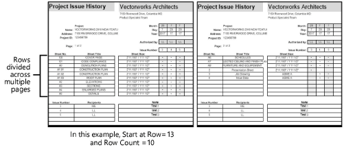

Inserts the data into the worksheet and creates additional pages as needed to accommodate all the rows of title block border data; this is useful if a project has too many rows to fit neatly on a printed page.
The worksheet will contain information from title blocks in external files only when this option is selected.
Start at Row
If creating a multiple page worksheet, specifies the first row of the section in the worksheet to divide across multiple pages
Row Count
Specifies how many rows after the Start at Row to put on each page of the worksheet

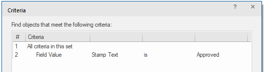

Managing title block report criteria
The Title Block Criteria Manager lets you create criteria to select specific title block borders for reports. Create as many criteria as needed, or import them from another file.
To add, edit, delete, or import title block report criteria:
From the Title Block Manager, click the Criteria list, and then click Title Block Criteria Manager.
The Title Block Criteria Manager dialog box opens, and displays the current criteria by name and criteria formula.
Do one or more of the following:
Click Add or select a line item and click Edit; specify criteria for which title block borders to include in the report, as described in The Criteria dialog box. This may look something like the example below.
Delete a selected criteria item.
Click Import and browse to an existing Vectorworks file, and import the criteria from it.
Click a line item, and then click the icon to the right of the name to edit it; new criteria are automatically given a default name and must be renamed.
Create as many criteria as needed, and then click OK.
The criteria are available for selection in the Criteria list when you create a report.
