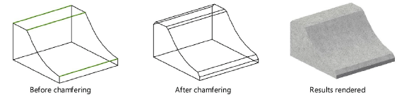

The Chamfer Edge tool modifies the edge of a solid with a linear cross section. Edges are usually modified during the detailed design phase of a project to provide a more realistic or aesthetic appearance to a model.
To chamfer the edges of a solid:

For tangent entity selections, select the tangentially connected edges and faces to be modified. For face selections, select the faces to be modified. To select multiple edges or surfaces, hold the Shift key while selecting. To select the back faces of solids, press the Alt key (Windows) or Option key (Mac).
See Selecting the edges and faces of a solid for information on selecting surfaces.
When Select All Edges is enabled, clicking on one of the highlighted edges selects all the edges for chamfering.
Press Enter or click the check mark button on the Tool bar to perform the edge modification.
The Setback value for the chamfered edge can be edited through the Object Info palette.
Once the modification is complete, the edge set used to create the modification cannot be changed. The modified edge can be ungrouped, and a new modification with different edges can be created.
