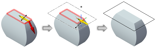

Depending on the mode, selected edges (left) or all the edges in an edge loop (right) can be offset onto the adjacent face
