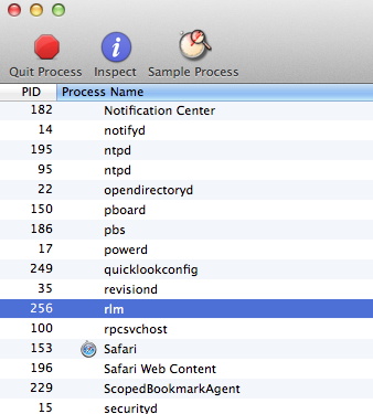

To shut down the RLM server using the Activity Monitor:
Shut down the ISV server.
Select Application > Utilities, and launch the Activity Monitor.
Select rlm from the list of processes.
Click End Process. Confirm that you wish to end the process by clicking Quit.
