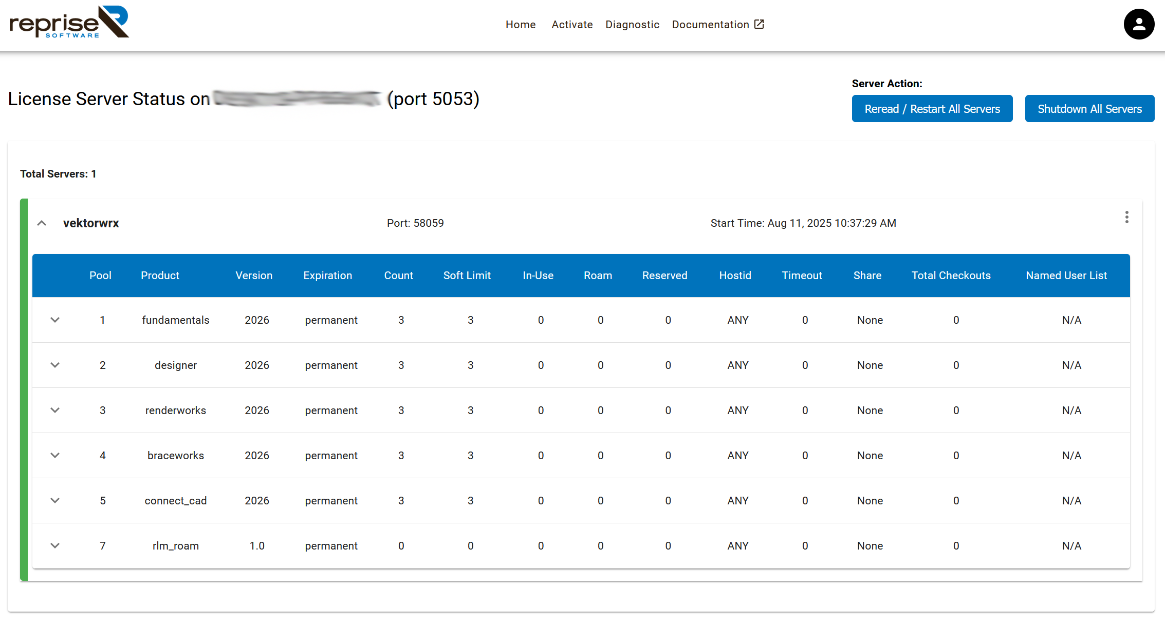

The server administration Home screen opens. reprise.pngFrom this screen, you can view the status of the server and the licenses, perform quick server actions, manage users, run diagnostics and perform other actions. Some of these commands are also available from the site protection System Menu. See Site protection System Menu.

Server status table
The table on the server administration Home screen displays the vektorwrx server status.
Each row of the server displays the product, version, license type, number of licenses, licenses in use, and more. Expand each row by clicking the disclosure arrow for more information about the licenses in use.
Parameter
Description
Pool
The license pool number
Product
Displays the license borrowing settings file, rlm_roam, for internal use by Reprise software
Version
Shows the version of the product
Expiration
Displays the expiration date of the license. "Permanent" indicates a license that never expires.
Count
Shows the number of licenses available (the total number owned minus the reserved seats for that product)
Soft limit
For Vectorworks software, displays the count plus the number of reserved licenses (the total number of licenses)
In-Use
Shows the number of licenses currently used
Roam
Shows the number of licenses currently borrowed. If no clients are currently borrowing a license, this item is not shown.
Reserved
Shows the number of licenses reserved
Hostid
Indicates whether the license is protected by hardware, such as a dongle. Since the Vectorworks server software itself is protected by a dongle, this item displays ANY.
Timeout
Shows the number of timeouts
Share
Shows whether the license is shared (opened many times by the same user on one machine). For Vectorworks software, license sharing is not permitted, so this field always shows None. If the same user opens multiple instances of Vectorworks on the same machine, multiple seats will be used since sharing is not permitted.
Total Checkouts
Shows the number of times the license was checked in/checked out
Named User List
Shows user information.

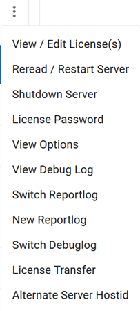

Server menu
The Server menu, accessed from the top right corner of the vektorwrx server status table, accesses the functions of the Vectorworks Site Protection Server. A summary of the main functions is provided here, with links to further explanation.
Many of these functions can be more easily performed from the Site protection System menu. See Site protection System Menu.
Menu command
Function
View/Edit License(s)
Views or edits the license file. For more information, see Modifying server port numbers
Reread/Restart Server
Opens the Reread/Restart Server screen, to refresh or replace a license file; see Restarting the ISV server.
This operation can also be performed from the ISV Servers section of the Status screen.
Shutdown Server
The Shutdown License Server screen opens, to shut down the ISV server; see Shutting down the ISV server.
If the rlmdown command was disabled, as described in Server startup options, then this button does not display.
License Password
Enter a user's password to view the licenses associated with the user. From there, you can add or remove licenses assigned to a user.
View Options
Displays the RLM options; the RLM server handles the core functions of license management. The privileges that can be assigned or restricted are defined in User management.
View Debug Log
Shows the Debug log; see The Debug log
Switch Reportlog
Closes the specified ISV server's Report log file, and switches the logging location to a new log file with the specified name. For more information, see Switching to a different Report log file
New Reportlog
Creates a new Report log file with the specified name for the specified ISV server. For more information, Creating a new Report log.
Switch Debuglog
Closes the Debug log file, and switches the logging location to a new log file with the specified name. For more information, see Switching to a different Debug log file.
License Transfer
Does not apply to this software
Alternate Server Hostid
